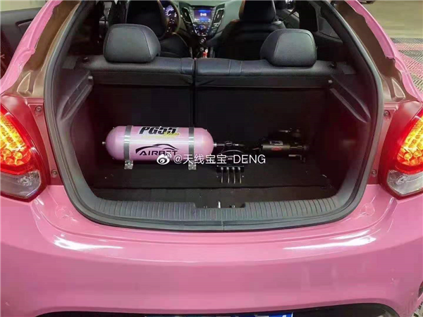

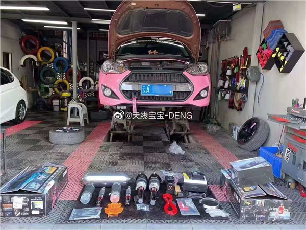

话说这是个什么东西呢?它其实是一套可以控制气压,改变车身高低的装置与传说中的主动车身控制系统(ABC)类似不过它的工作介质是气体,一般来说就是下图所示的这么一套家伙事,其中包括弹性橡胶气囊减震器气压控制系统、后备箱储气罐及电子控制系统等,它其实和空气减震的原理与常见减震器,螺旋弹簧+减震筒形式原理十分类似,只不过通过改变气室体积(上下方向),来调整车身离地距离并一定程度改变软硬特性,另外减震筒部分则可以由电机改变通气孔尺寸从而调节减震器的衰减力,因此空气减震器往往能提供更好的性能表现,嗯!就是这么自信!
So what is this? In fact, it is a device that can control the air pressure and change the height of the car. It is similar to the legendary active body control system (ABC). However, its working medium is gas. Generally speaking, it is such a set of things as shown in the figure below, including the air pressure control system of the elastic rubber airbag shock absorber, the air storage tank of the trunk and the electronic control system. It is actually the original of air damping The principle of coil spring + shock absorber is very similar to that of common shock absorber, except that the distance between the body and the ground can be adjusted by changing the volume of air chamber (up and down direction), and the soft and hard characteristics can be changed to some extent. In addition, the damping force of shock absorber can be adjusted by changing the size of air vent by motor. Therefore, air shock absorber can often provide better performance ! So confident!
